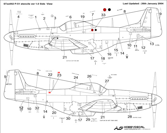

At first I was concerned about where all the stencils should go as there wasn't a placement guide with them, then I remembered that the placement guide is on their site (click here to go to their placement guide page), there are three pages for each plane showing both sides, the top, and the bottom. Some modelers may have preferred a placement guide included with the stencils, but they're easy to use either from your computer or downloading the photo (they're also working on Adobe files for each of the placement guides) and by doing it this way they have been able to keep the cost down per sheet because the dry transfers are more expensive to produce than waterslide decals.
Looking at my references I was only able to find one discrepancy on the top view of the placement guide, the black and white stripes are shown in front of the flaps and should only be visible on the curved part of the flap when the flap is lowered. It is in the appropriate position, but should have a note stating not to use them if the flaps aren't lowered.
