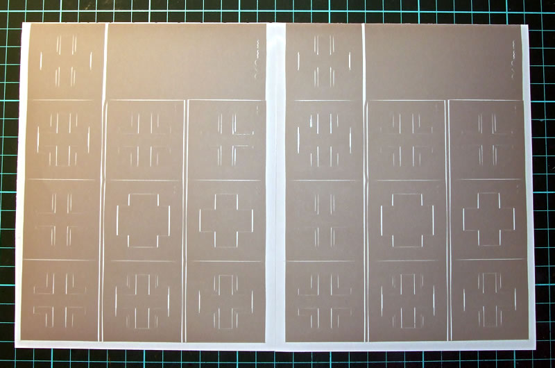

The masks are pre-cut in a very thin self-adhesive vinyl. The vinyl is noticeably thinner than standard masking materials. They do have a tendency to stretch, however, so careful handling is required once they're free from their backing sheet.

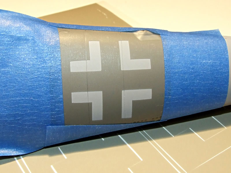

The masks are relatively simple to remove and apply. Great care needs to be exercised during placement, however, as they're not as forgiving as waterslide decals:
The instructions recommend spraying the model lightly with water, allowing you to slide the mask into position, rather than having it simply 'grab' the model. For this reason, application over gloss or semi-gloss paints is recommended. For my test, I primed the surface with Mr Surfacer 1200, and then gave it a light polish with some worn wet'n'dry. I didn't try the water method, however, since position wasn't critical, but I may do so next time.
A very light spray with some Tamiya XF-2 Flat White:
Masks gently removed:

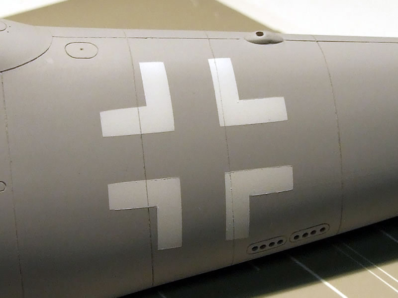

Mask adhesion is adequate to ensure a good seal, but shouldn't worry properly-cured paint of any description. Removal was a simple matter of gently pulling the masks back over themselves.
While there are some noticeable ridges around the lower horizontals, they're more a symptom of overzealous airbrushing than any fault with the masks themselves. Besides, those ridges will polish out nicely, and after clear coats and weathering, should be way less noticeable than decal edges. Here's a shot at something closer to normal viewing distance:
I think the result is excellent, and am happy to recommend these masks if you want that painted-on look. I have several more sets for review, and will look to test those in a compound masking situation, which is more typical for most styles of national marking.
