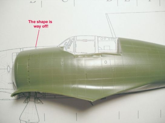

The fuselage detail is quite good. Panel lines seem to be there for the most part but some panels are missing and will need to be scribed for better accuracy.

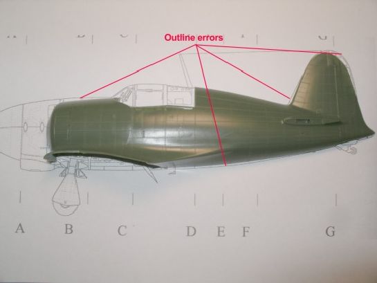

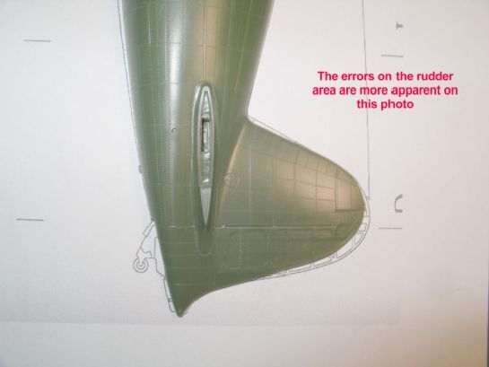

I compared the fuselage with enlarged scale plans published in the Mushroom Model Magazine Special (Yellow Series) Mitsubishi J2M Raiden. As you can see by the photos, the upper section forward of the cockpit is misshapen. The same goes for the rear section all the way to the rudder, which is slightly too tall. These areas can be corrected with either Milliput or by adding plastic card to build up the sections. This by the way is the only major fault found with the kit.

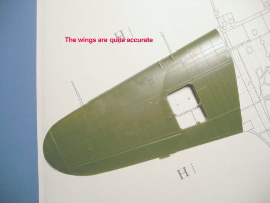

The wing shape is surprisingly good though the wingtips seem a little too pointy, but this is easily fixed by gently sanding them to shape. As mentioned above, some missing panel lines will need to be scribed here also. There are no wheel wells present, only large holes for the toy like retracting landing gear system. These will need to be built from scratch. The landing struts seem a little fragile looking and will require extra detailing, maybe even a partial rebuild. The wheels are undersized and will need to be replaced with new ones built from scratch or some similar ones in resin. Revell included both plastic wheels and optional plastic rims with rubber tires. These also are undersized.
