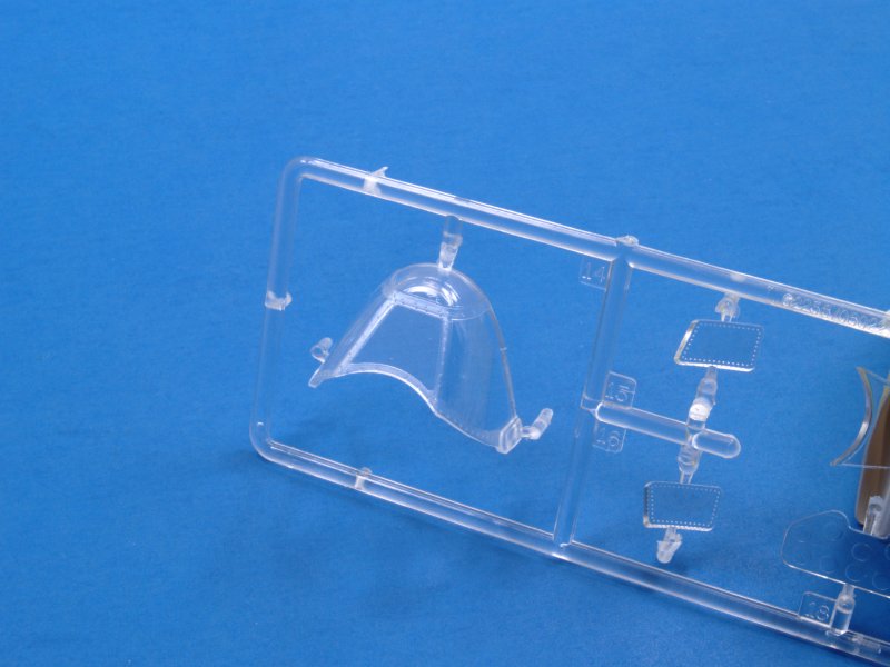

The parts layout is almost exactly the same as in the F6F-5N kit – with one exception. A new sprue with the correct windscreen has been substituted for the -5/-5N windscreen. The clear parts are nice and thin with almost zero distortion or flaws.

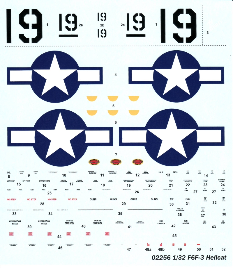

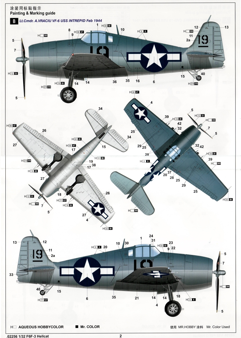

The decals are nice and thin with great registration. However, the fun-bus slams on the brakes right there... The colors look alright, although the insignia blue does look a little “too blue”, but the alignment of the stars and bars if incorrect. The bars in the insignia are too low. In every reference I've found the star and bars are aligned, or in some cases, the star is slightly below the bars. Trumpeter has this reversed. On top of this, both of the markings options are incorrect. In February of 1944, Vraciu was flying “white 19” not “black 19”. In fact, I don't think I've ever seen the upper aircraft numbers, e.g., the fuselage and tail numbers, in black on the Hellcat. In addition, he had already scored some victories and had a scoreboard on his aircraft.

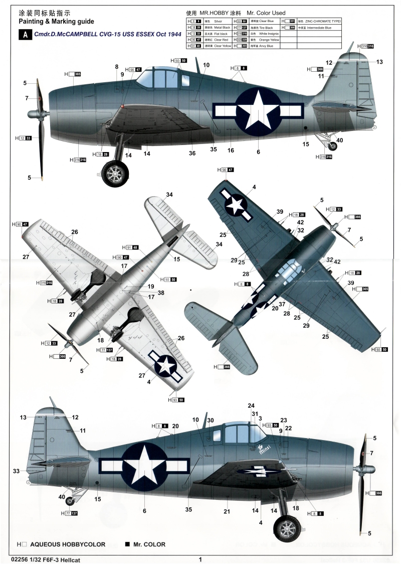

On McCampbell's aircraft, Trumpeter overlooked the decals for the white CAG fin flash at the top of the vertical stabilizer. It is included in the painting callouts as a simple white stripe across the top of the tail. Trumpeter neglected the blue “CAG” designation that goes inside the stripe. However, what I find interesting, and the strangest error in the markings, is the actual markings themselves. Trumpeter asserts that this particular aircraft was marked this particular way during October of 1944. However, McCampbell didn't fly “The Minsi” during October of 1944 – he had already received a new -5 and named it “Minsi II”, followed shortly afterward by another -5 named “Minsi III”. The first of the Minsi's, “The Minsi”, was replaced by “Minsi II” in September of 1944. So, perhaps Trumpeter didn't do enough research, or perhaps they meant to type “September” instead of “October” on the markings guide.
