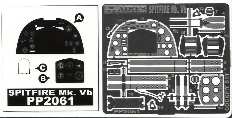

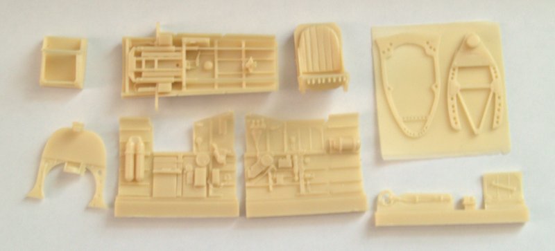

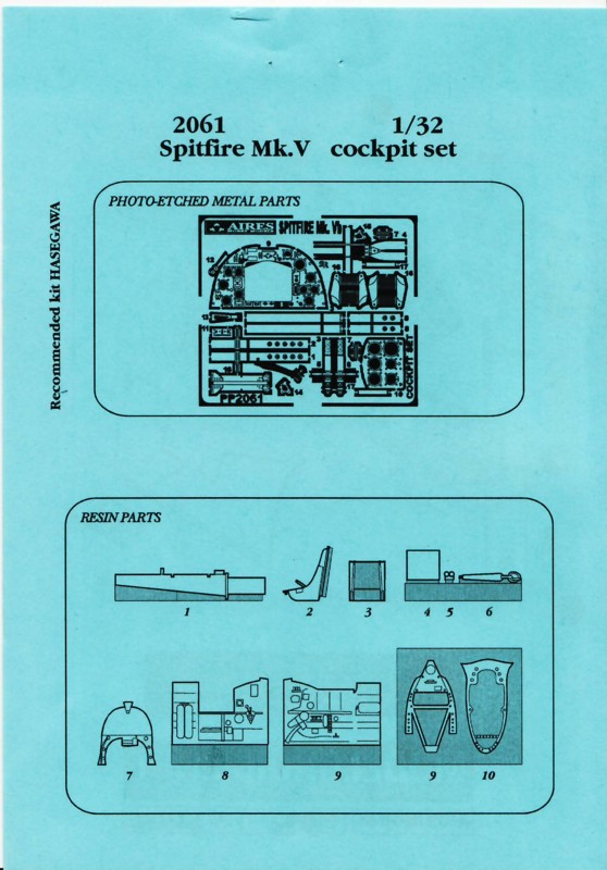

So, what's in the box? It all arrives packaged in the typical Aires plastic bubble pack - a very sturdy arrangement. The set itself contains 11 peices of biege colored resin, a fret of photoetch, and an acetate film for the instrument panel and the gunsight glass. The photoetch fret contains the main instrument panel and the panel for the flight gauge cluster, the rudder pedals, and the Sutton harness. The harness is composed of 11 parts and should look very nice when built up. One detail Aries provides is the cabling through the rear bulkheads that was a component of the Sutton harness. I'm partial to the photoetch instrument panel with acetate guages. I feel that combination renders a very good scale instrument panel that looks very well done when the cockpit is opened up for viewing. Some white paint on the back of the acetate, sandwich it all together with Future, and presto!

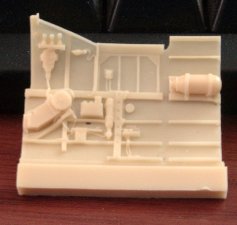

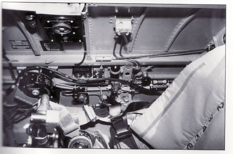

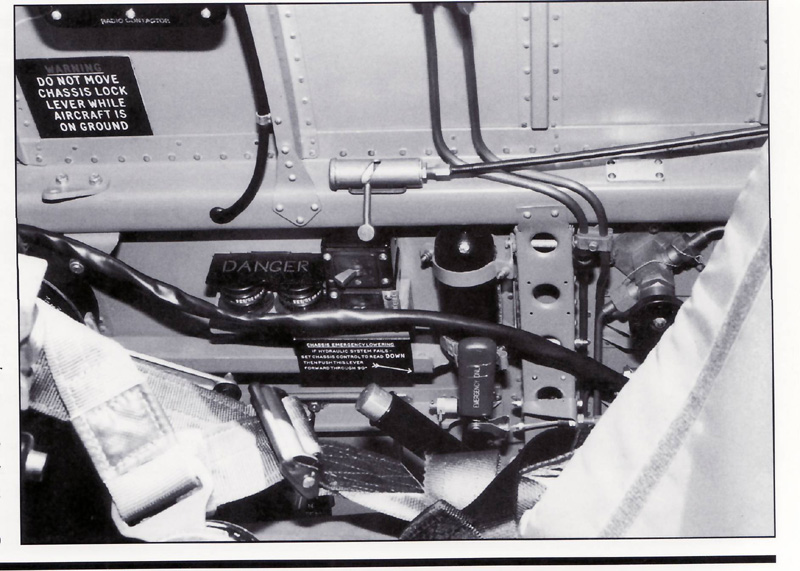

The resin parts are well done with no flash and minimal casting blocks. So, when it comes time to build it up, you'll spend more time actually building, painting, and weathering, rather than most of the time struggling to saw off the casting blocks and clean up the excess flash. The detail on the resin bits is outstanding. It is very delicate and well done. This is evident in the hydraulic lines coming from the undercarriage lock as well as the hydraulic lines running from the chassis controls. The amount of detail contained in the set is fairly complete - the modeler may wish to add some electrical wires to the ribbing as needed. Be sure to check your references. One possible omission that caught my eye was the lack of the remote contactor on the starboard sidewall. It's the big black box in the upper left corner of the photo on the left below. The photos below were taken from Volume 35 of the Warbird Tech Series,Merlin Powered Spitfires by Kev Darling, and are fairly representative of the Mk.V Spitfire. However, some photos from Morgan and Shacklady's,Spitfire, The History, show the distinct lack of a remote contactor. So, bottom line, you make the call and check your references for your specific model.

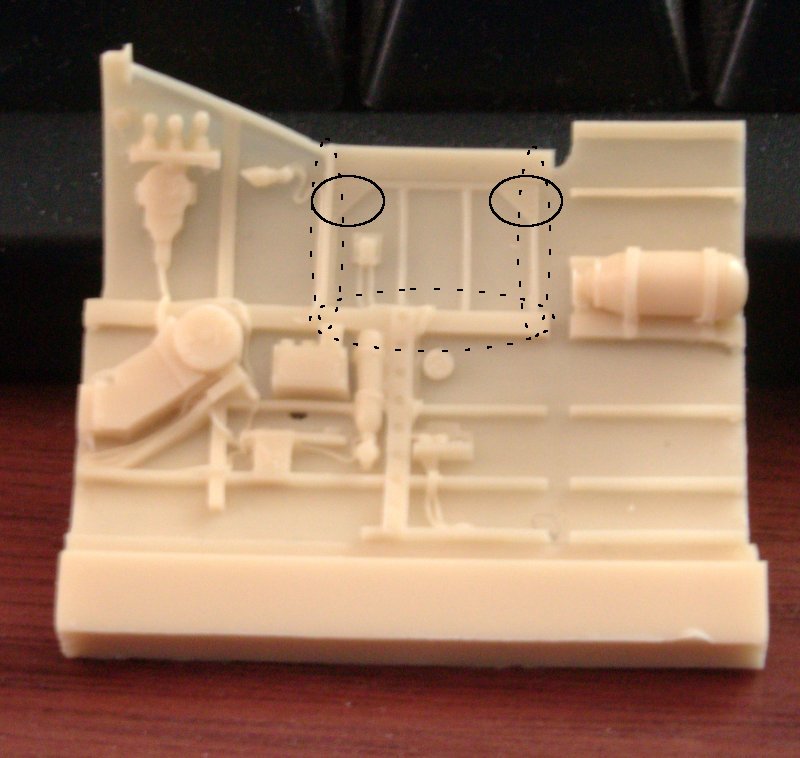

There has been some speculation around the 'Net on various sites concerning the mysterious appearance of a starboard door. Some started to complain that Aires got it wrong. Others screamed, "It's sacrilege! Two doors on a Spitfire... Get the torches!" Well, alright, no one grabbed any torches. However, people were wondering why the "door" was there in the first place. At first I couldn't figure out what everyone was on about. Then, as I was staring at the starboard sidewall shown above, I realized what appeared to be the "door of mystery"... Examining the photos above, the Aires' representation of the internal structure is absolutely correct. The door appears to be an illusion created by the internal ribbing circled with dashed lines below, and accentuated by the oversized corner braces circled below. This illusion is bolstered by the gaps in the stringers to allow for the fitting of the rear bulkhead.

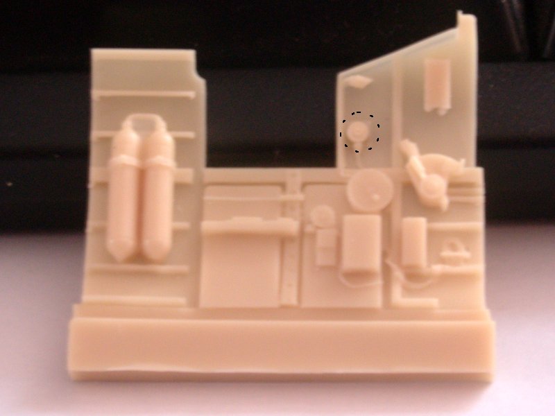

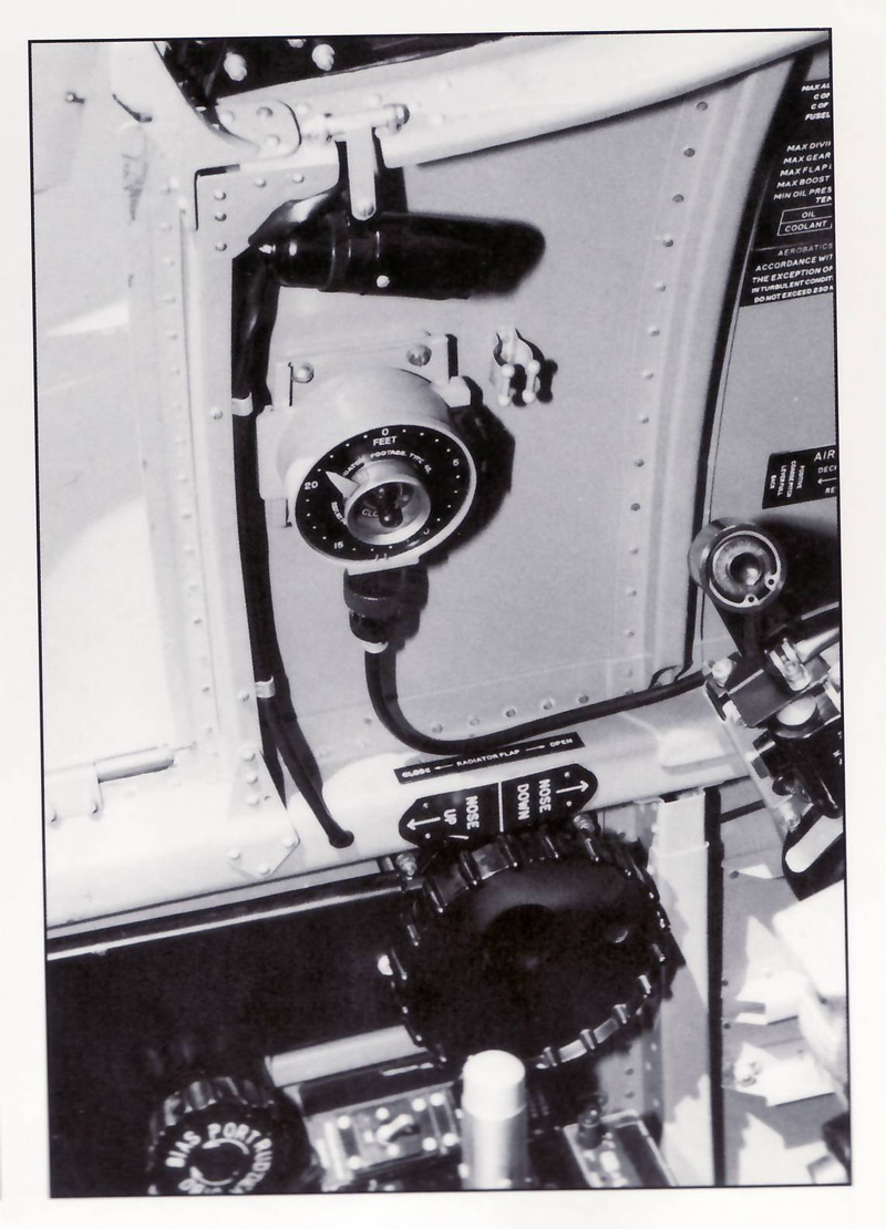

Another item that caught my attention appeared on the port side of the cockpit. Aires modeled the camera controls into it's port sidewall. The cockpit between the Mk.V and it's P.R. variants didn't change, so if the modeler desired a photo recon version - Bam!, there you go. If, however, you want a non-P.R. version - and you're quite anal about the little stuff - you better get out the scraping tools. Remember, only remove the round control unit, not the utility plug with the wiring below it. Most Spitfires retained the wiring harness for the control unit. See images below for greater detail.
