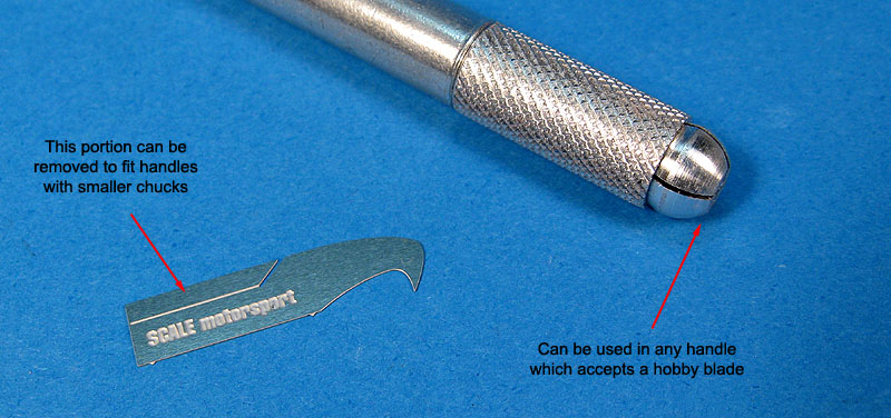

Scale Motorsport is a modeling brand dedicated to car modeling, but when I had the chance to test their new scriber, I didn't let it pass. It is a photoetched scriber blade set designed to fit in most hobby tool handles. It fits X-Acto handles, but to install it in a Olfa handle you have to to break off the engraved slab on the top of the blade.

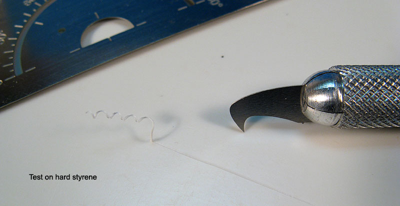

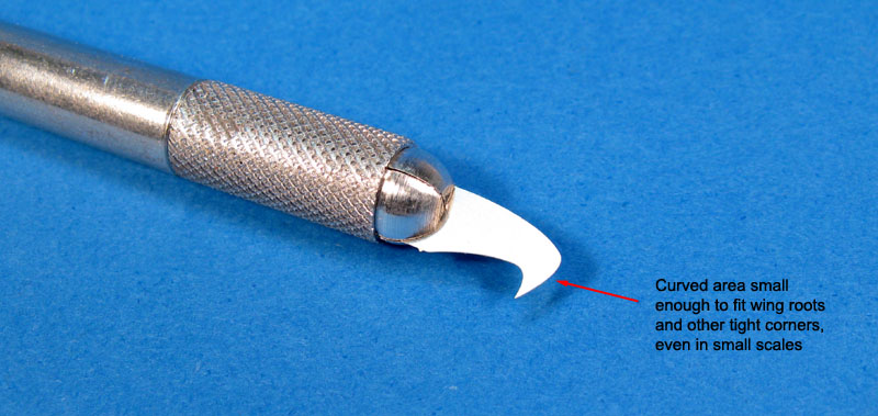

The blades themselves are very thin - 0.2 mm, and yet very stiff against bending, thanks to the very hard stainless steel used. The shape of the blade resambles an Olfa or Tamiya cutter, but smaller, allowing to use it inside tight corners like wing/stabilizer roots.

I tested the tool on two samples of styrene, a hard one and a soft one. It worked pretty well on both. In the hard styrene sheet, it is just a matter of finding the suitable pressure to avoid gripping. In all my tests, the scriber actually removed a hair of plastic. I didn't even find necessary to sand the scribed line afterwards

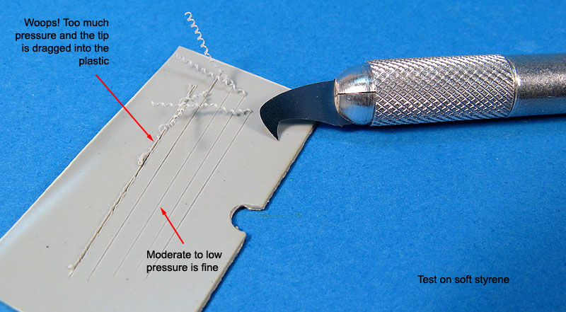

The performance on the soft styrene sheet was equally successful. In this case, however, you should keep pressure to a minimum to avoid the tool from "digging in" the sheet. Once you find the correct pressure, the resulting line is very thin and consistent.
