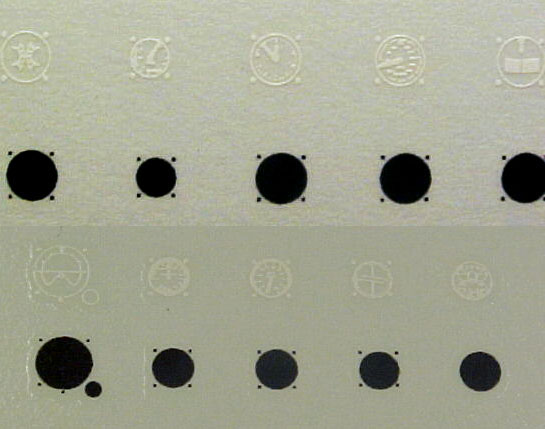

These instruments are printed in a somewhat different way than most instrument decals: the dials are printed in white between two clear layers, and each dial comes with a separated base decal printed in black. The instructions claim that after applying the black bases to the correct positions on the instrument panel, and then the white dials over these, you get black & white instrument bezels with a clear coat over them simulating the glass.
The approach is questionable because the boundaries of the clear film are not circular like on the actual instruments. It is kind of square to reach the rivets/fasteners printed with each dial. Add a bit more clear film to take into account the printing tolerances and that will result in much more "glass" than desired. On the other side, there is no out-of-register problem...
If you are going to use the suggested method on a typical flat black panel, I recommend you to apply the instruments and seal them all with a coat of your favorite flat varnish over the whole panel. Wait until dry and them place small drops of gloss varnish over the dials. This will give a more accurate finish.
But the real value of these instruments is in another possibility: cut the dials using a punch and die set and apply them on the correct positions using the kit part. No mess. If you prefer, it is possible to go even further and make a new panel using the well known "sandwich method": scratchbuild a new front panel with the instrument holes punched out and paint it with the correct color. Then scratchbuild a back panel without the holes and apply the instruments on it using the suggested instructions (to save time, apply only the white dials on a black panel) so that the dials match the corresponding holes of the front panel. Finally, glue the panels with a thin clear acetate sheet between them.
A zoom on some of the dials and their black bases.

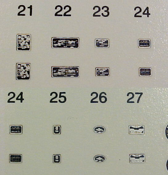

DATA PLATES
A strong point of this sheet is the data plates. Wow, data plates? How we 1/32ers miss this sort of thing. In most cases we have to hand made them or adapt something from other manufacturers. I don't understand why decal manufacturers hesitate in doing generic sheets containing this stuff.
This sheet contains seven different plates (all rectangular but one, elliptical), numbered 21-27, in ten rows totaling 70 plates. They are printed in black & silver and well spot on. The instructions list only the numbers 21 and 22 as the Wright and the Pratt & Whitney engine plates, respectively. The others are miscellaneous plates for general use on sidewalls, access panels, landing gear struts etc. They look superb and surely will make the difference in this scale.
There are also 39 smaller assorted white panel placards with black or red stencils to be used wherever you want.
Data plates

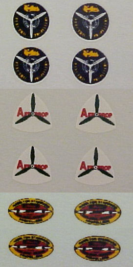

PROPELLER LOGOS
Propeller logos are another type of decal in 1/32 that are not good or accurate when they come with most kit decals. This sheet brings logos for Curtiss Electric, Aeroproducts and Hamilton Standard propellers. There are 30 logos of each type, so you are plenty of this too. They are printed in several colors and my samples were perfectly on register.
I'm not sure if these logos had a standard size regardless the type/size of propeller blade. But in case they didn't, the error in the size won't be much noticeable.
Samples of the propeller logos.
