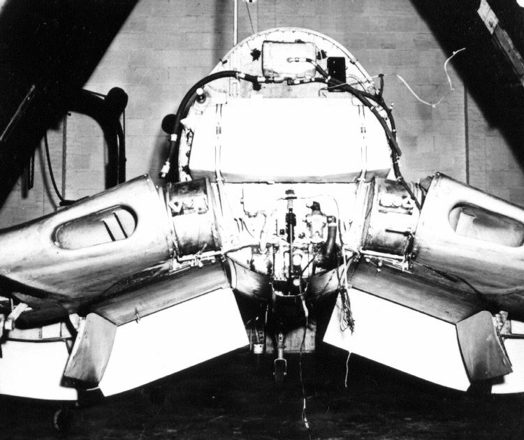

Don was advised by ground control to do “what’s best’s” so Don choose to try and “belly-in” his F2G as he had lost hydraulics and both gears were still up inside the wings with the access door’s closed. The enclosed photo is from Don’s personal photo collection, which shows that he successfully got the bird on the ground in one piece at the Akron, Ohio airport.

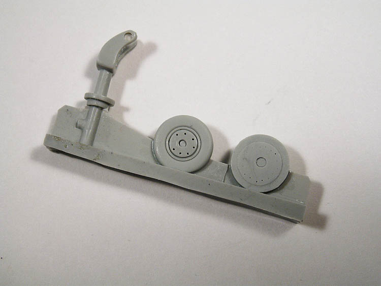

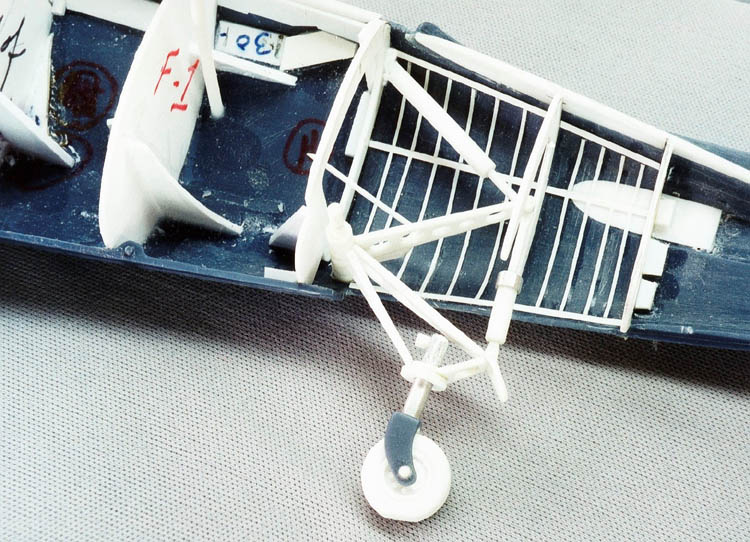

I don’t remember why I chose the “CRASHED-F2G” for my second project but maybe it was for this reason(s). “I can build it faster if I don’t revise the wheel wells and scratch-build the main landing gear struts, tires and rims.”

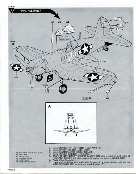

In the mid 1980s I bought several 1:32 scale Corsair F4U-1 kits made by Revell. The kit number is H-278-380 and is © 1970. I paid a whopping $7.00 for each kit. Somehow Revell got the kit’s I.D. data wrong as these kits are really F4U-1As. On page 6 of Squadron’s book No 29 it shows 10 side-view drawings of Corsairs. The first one is the XF4U-1. Next comes the F4U-1, which has a nickname of "birdcage". The third drawing is none other than the F4U-1A and the Revell kit is identical to said drawing. The 10th side view drawing show’s the F2G-2. The enclosed kit plans identifies that the model is truly a F4U-1A and not the F4U-1 Birdcage version.
BTW/FYI: All F2Gs that came off the assembly line were F2G-2s. There were no “real” F2G-1s. Had GAC’s assembly line got into production, the F2G-1s were to be built for the Marines and did not have folding wings, which would have been locked down in flight position. The F2G-2s were made for the Navy and had hydraulic folding wings. There were “NO-MANUAL” folding wings on the F2Gs. I had 3 GAC engineers relate this data to me, including Cook Cleland who owned 4 F2Gs.

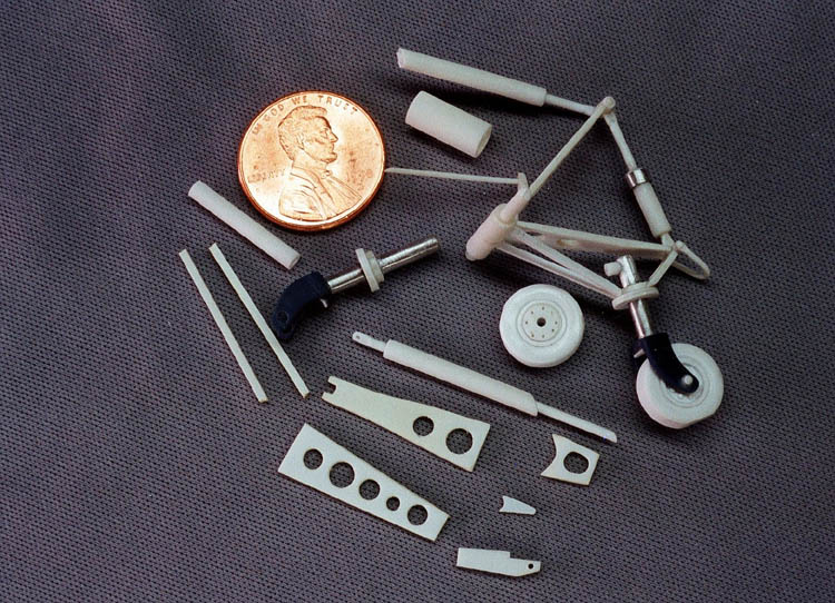

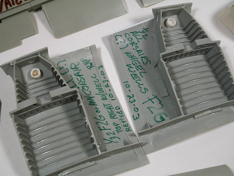

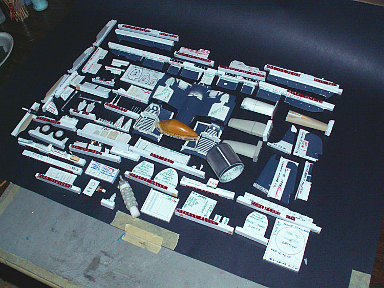

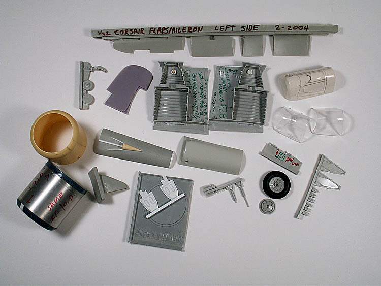

When I built No. 57 racer I made some master patterns as I knew I was going to build a few more 1/32 scale F2Gs using the old Revell F4U-1 kits.

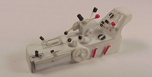

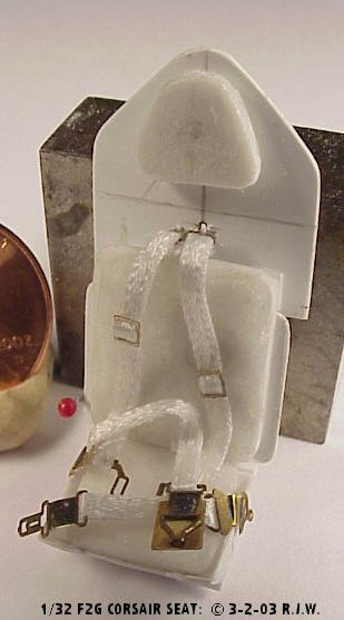

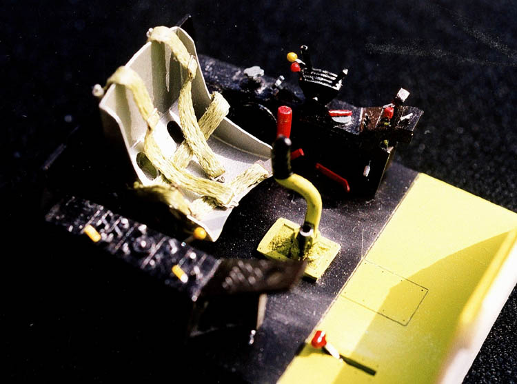

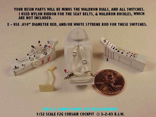

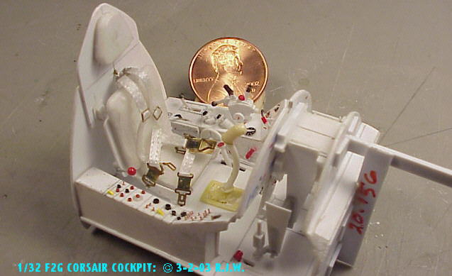

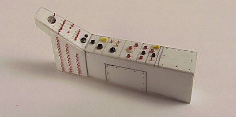

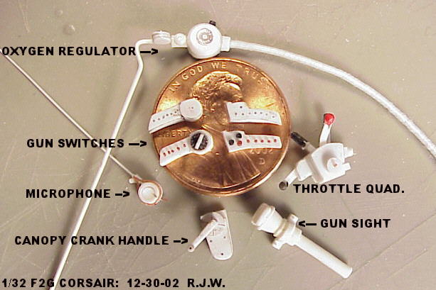

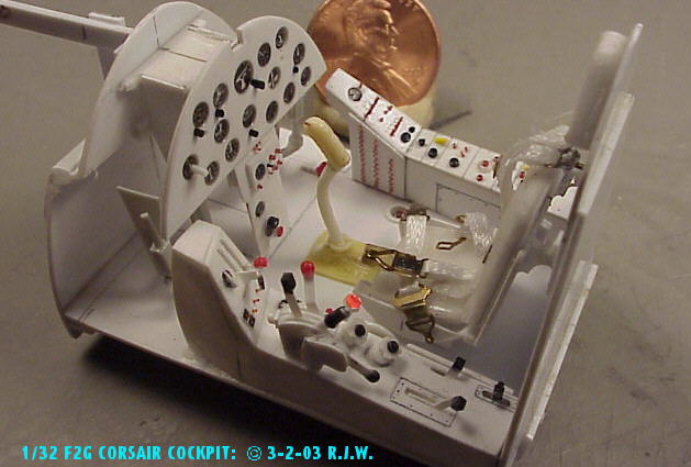

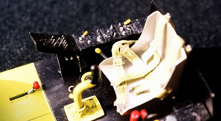

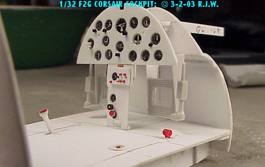

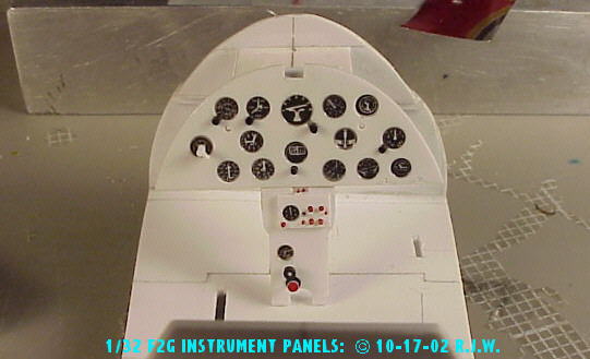

Using my pre-made cockpit patterns I cut out all the parts from some Evergreen card stock. Here are some photos showing the finished cockpit.

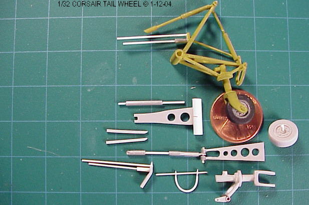

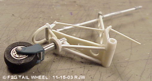

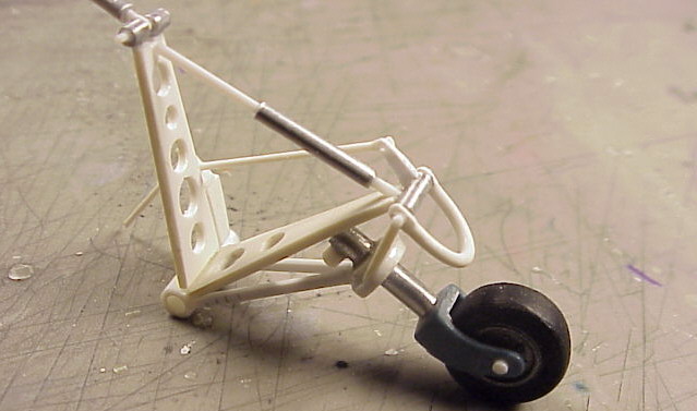

My next project was building the tail wheel area, including the tail wheel. You will note that the tail wheel and rim are white, which I carved out of card stock.

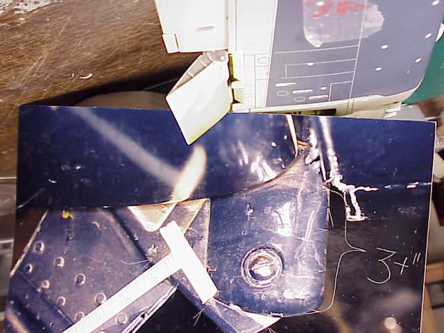

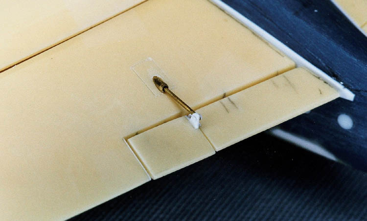

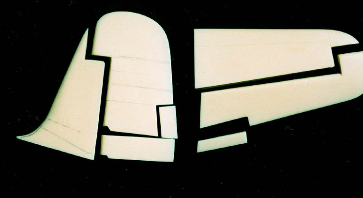

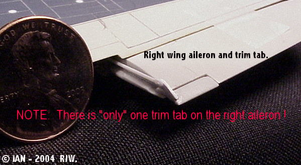

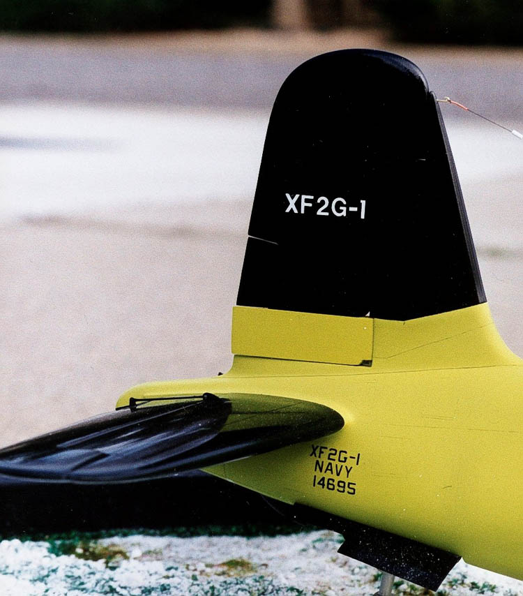

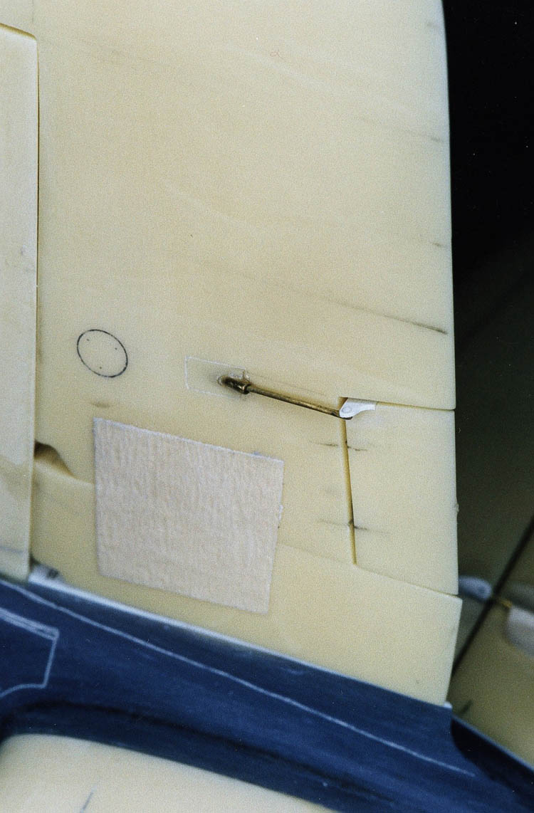

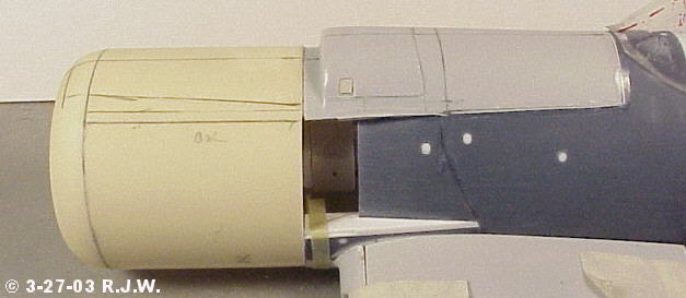

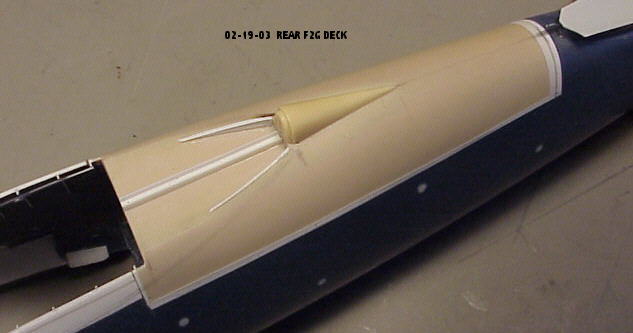

With the cockpit and tail wheel area finished I glued the two fuselage halves together as it was time to revise the fin, rudder and add the 11-1/2” tall auxiliary rudder. A few people wrote that the auxiliary rudder was 12” tall. I measured the auxiliary rudder on BU No. 88454 at Doug Champlin’s Fighter Museum in December, 1986. I used my master patterns and had Roy Sutherland cast my parts. I used some small diameter brass rod and built some push rods for my trim tabs. Bill Ferrante, another San Jose, CA modeler got into making cast resin parts so I got him to cast more parts for me.

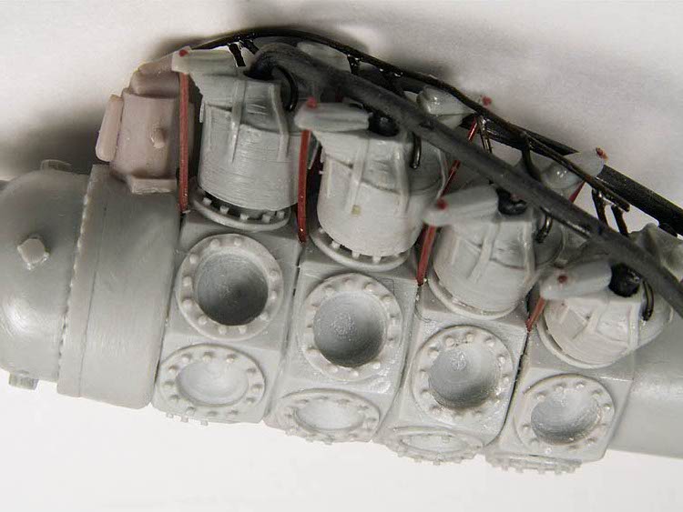

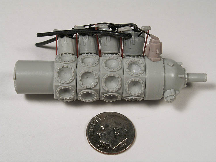

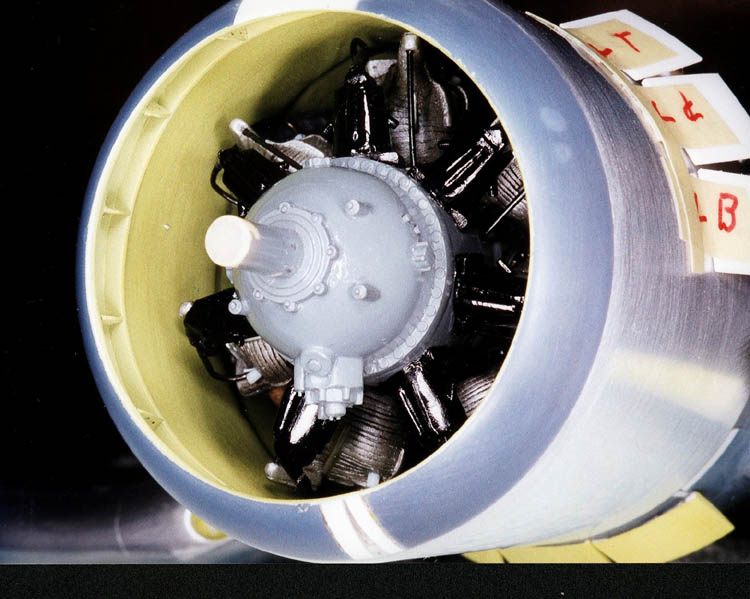

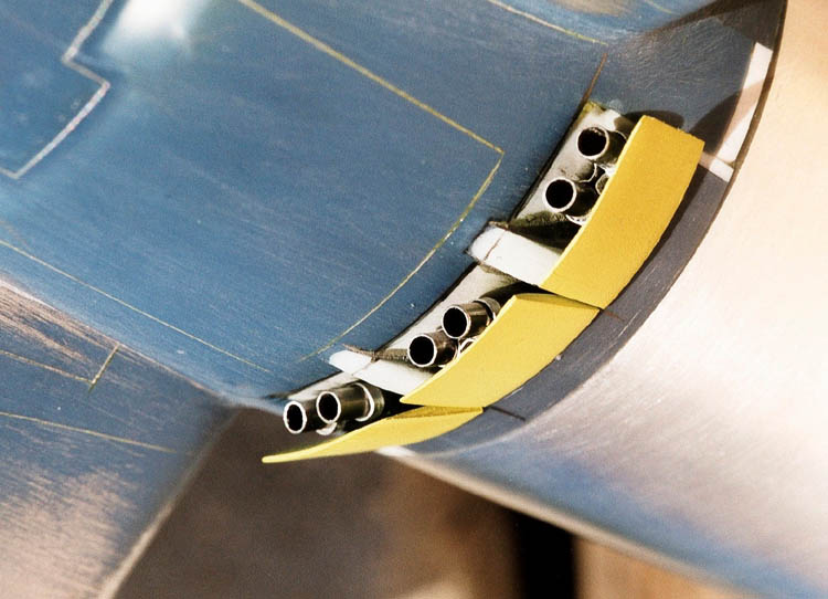

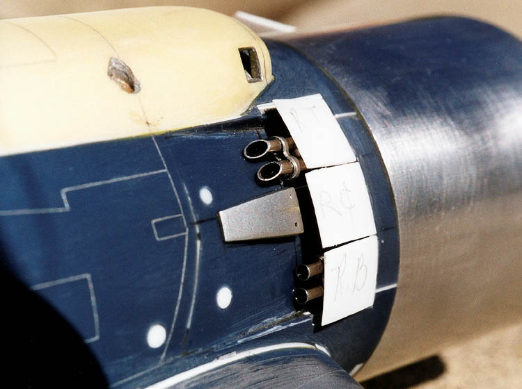

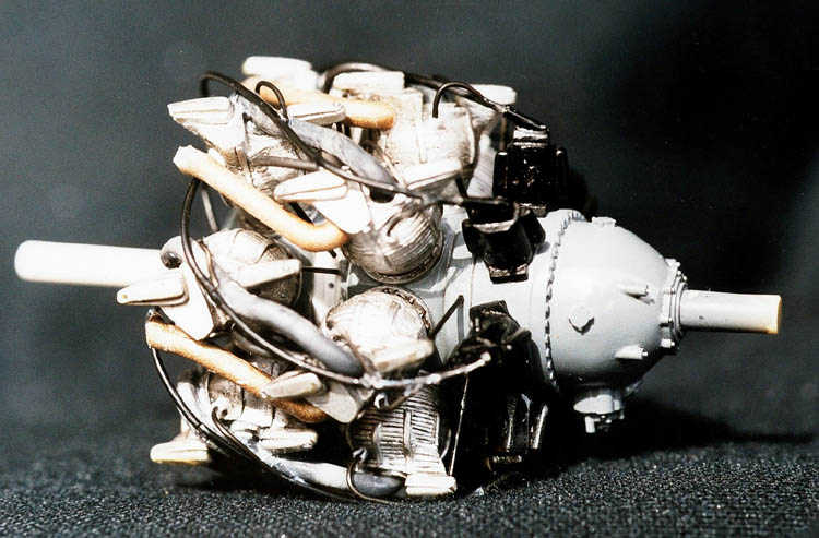

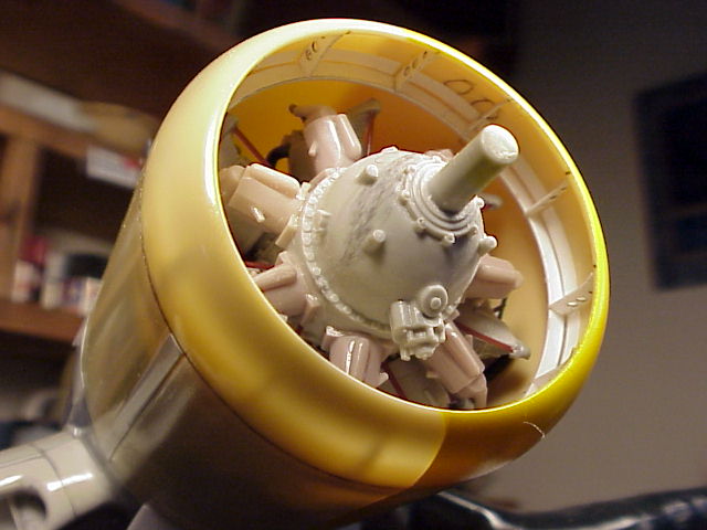

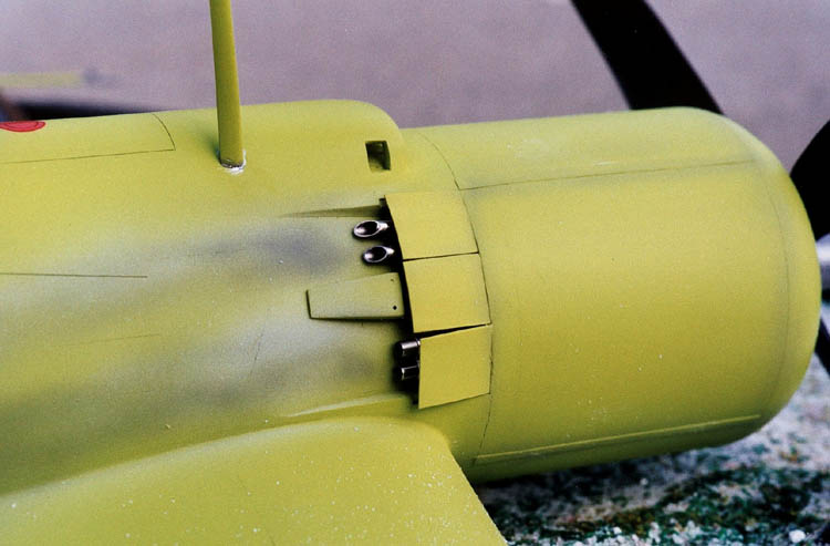

From experience I knew that you could see two rows of engine cylinders clearly so my engine conformed to this idea. In reality you could make out a third row of cylinder’s if you looked real close inside the new elongated cowling (forget the fourth row of cylinders). Bill cast my engine parts, including the one-piece cowling and a new 14’0” diameter 4 blade propeller with its hub.

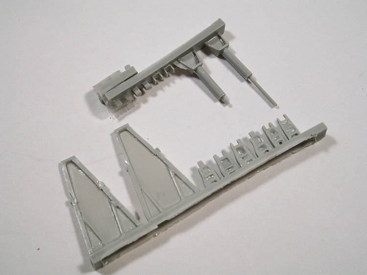

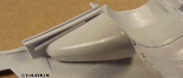

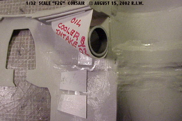

Bill talked me into making a master of the following parts: complete engine with 7 cylinders on each of the 4 banks, totaling 28 cylinders and 7 magnetos, exhaust stacks, wheel wells and their doors, hydraulic actuators, main gear strut, including the angle braces, tire and rim, flaps, ailerons and we included the tail wheel assembly. We tossed in both of the leading edge new style air inlets.

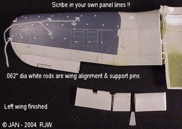

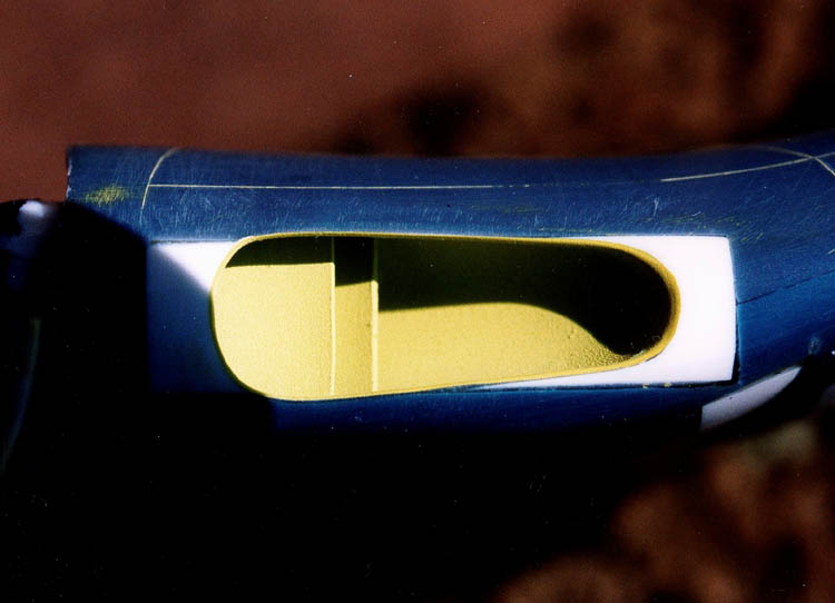

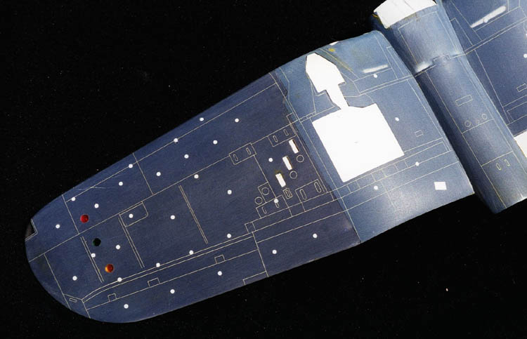

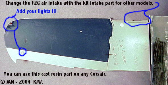

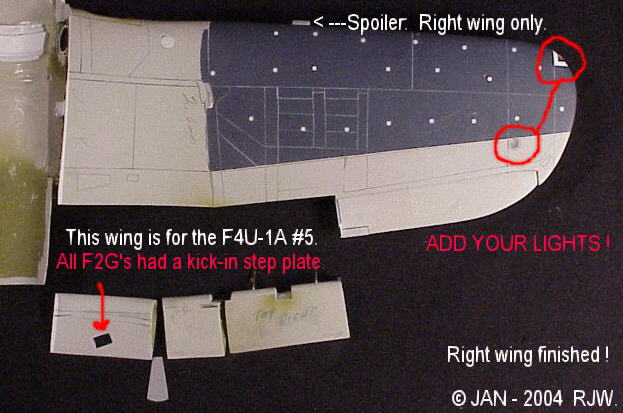

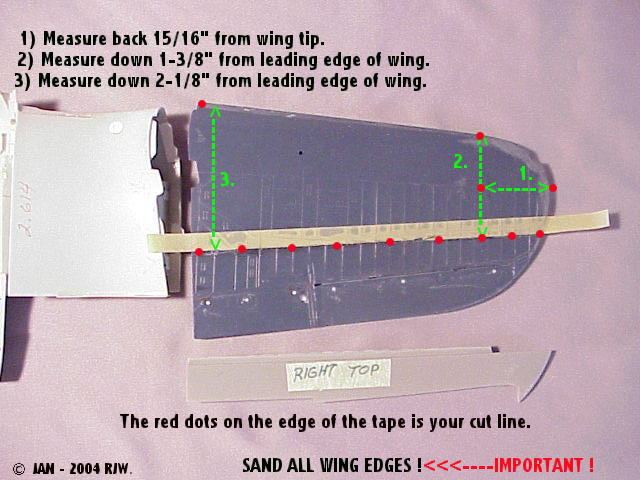

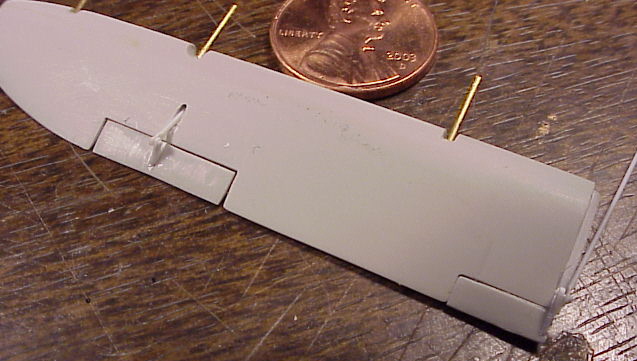

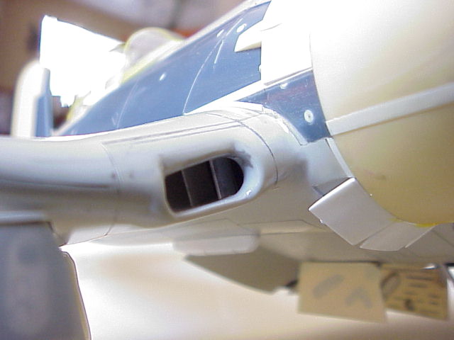

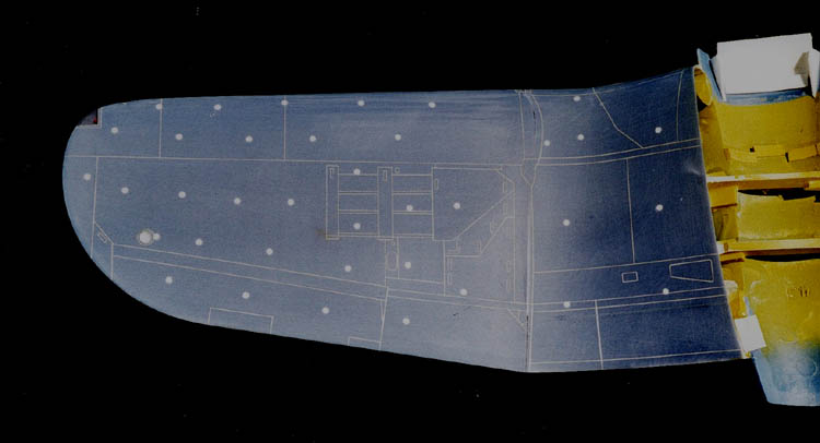

It’s time to work on the wing air inlets and close in the wheel-wells, then scribe-in all the panel lines. I handcrafted the clear wing tip lights and the round recognition lights on both wings.
With the fuselage finished, including the addition of all the panel lines, it was inspection time and of course there were a few minor things to fix. The 2 outer wing panels were aligned and glued to the inner wing section, which incorporated the bottom of the fuselage. A few more panel lines were added and some sanding was necessary.

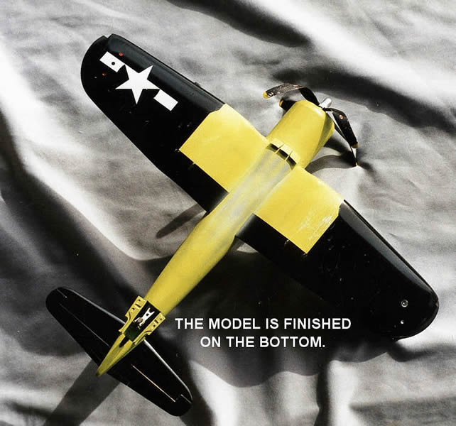

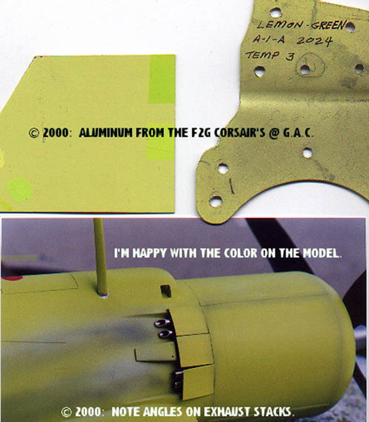

I have on hand a couple of pre-painted pieces of aluminum from one of GAC’s F2G Corsairs, dating back to 1945 so I did my best to match this color using my Tamiya Acrylic paint.

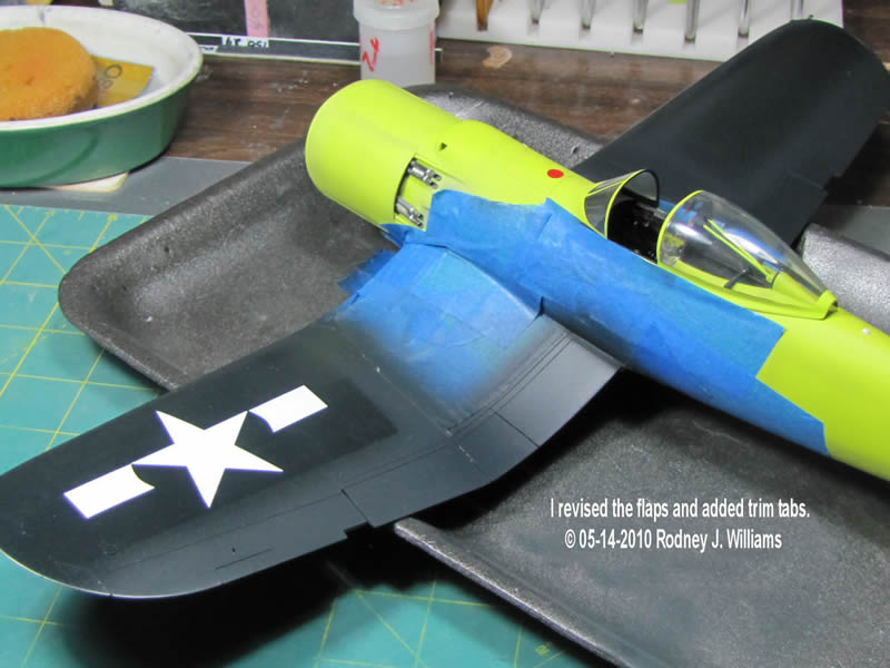

The fuselage and center wing sections were painted this chromate green color and the rest of the plane was paint the regular gloss sea blue. My research says that Vought shipped in the pre-painted outer wing panels, including the tail plane parts. You will note that the extension fin pedestal and auxiliary rudder are painted the same color as the fuselage. GAC fabricated those parts for all the F2Gs.

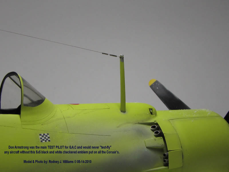

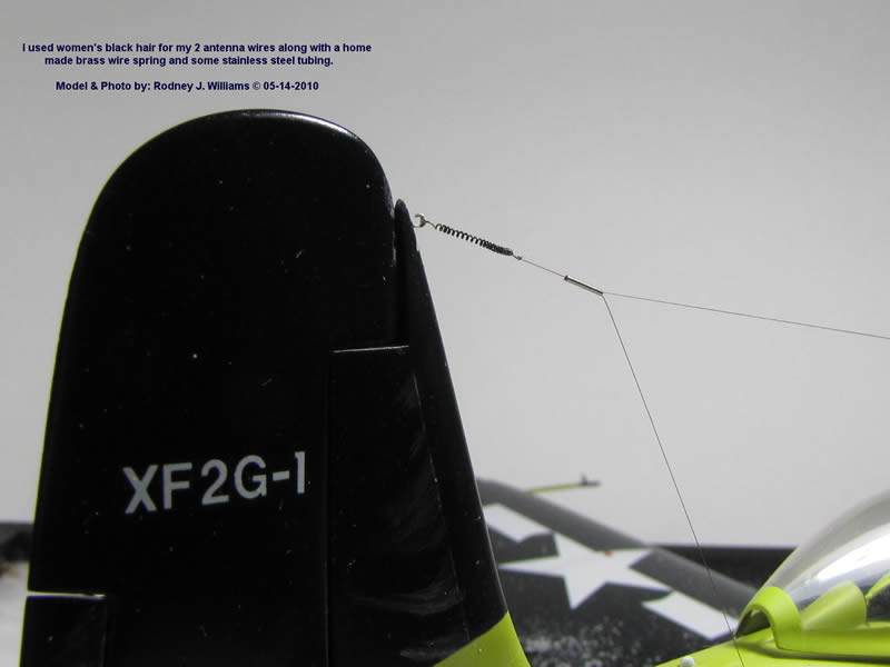

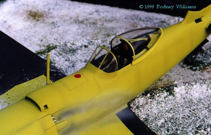

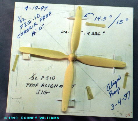

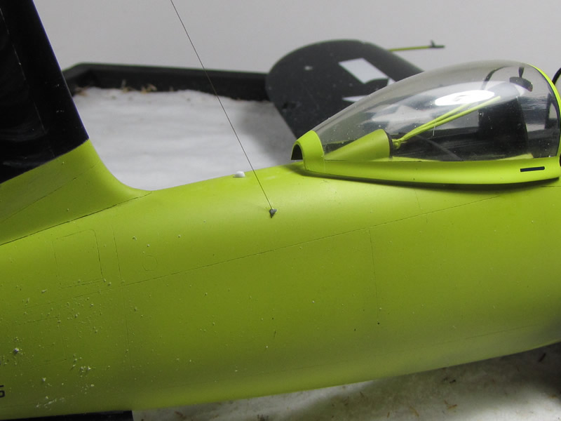

On final assembly the prop was heated over a burning candle then bent to shape. A pre-made tension spring was attached to the tip of the fin and then I added the ladies black hair for my antenna wire. I built a wooden base and covered it with modeling grass and I used “baking soda” for my snow.

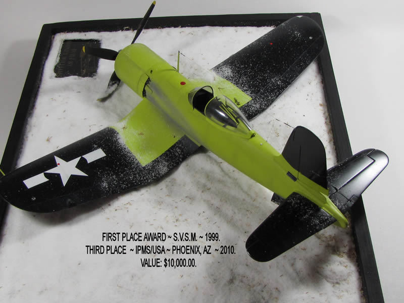

My records show that I started on this F2G project around 1991 and got the model finished sometime in late 1998. It was entered in our club’s annual contest in early 1999 and was awarded a first place trophy.

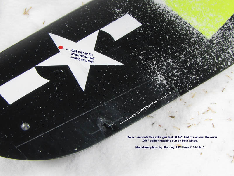

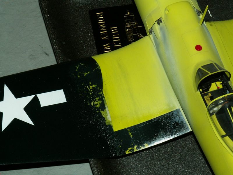

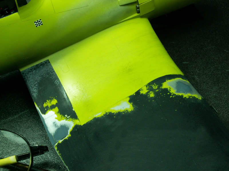

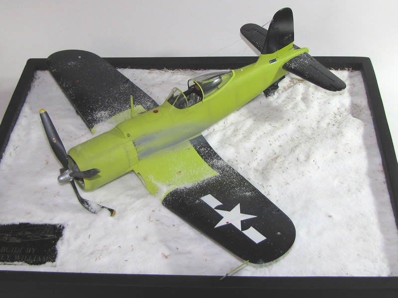

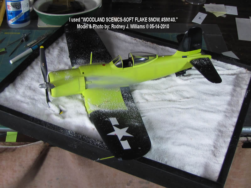

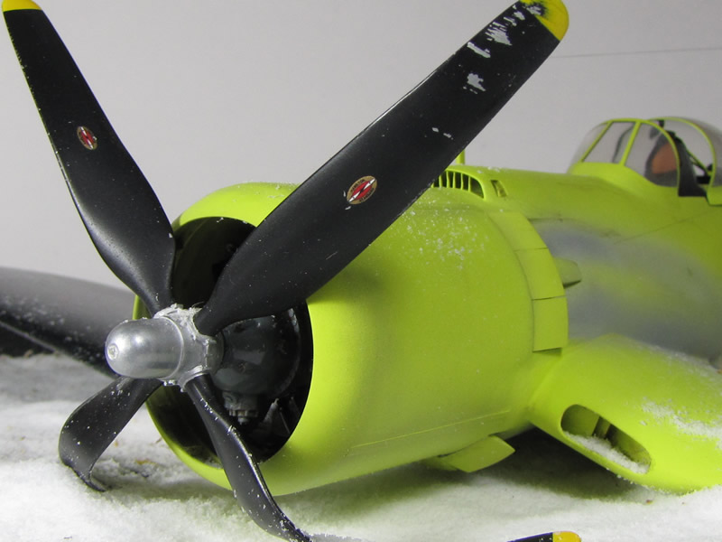

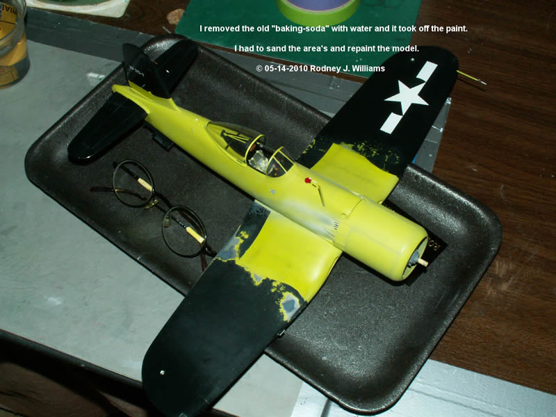

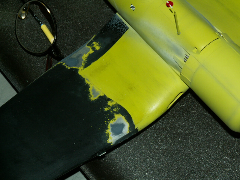

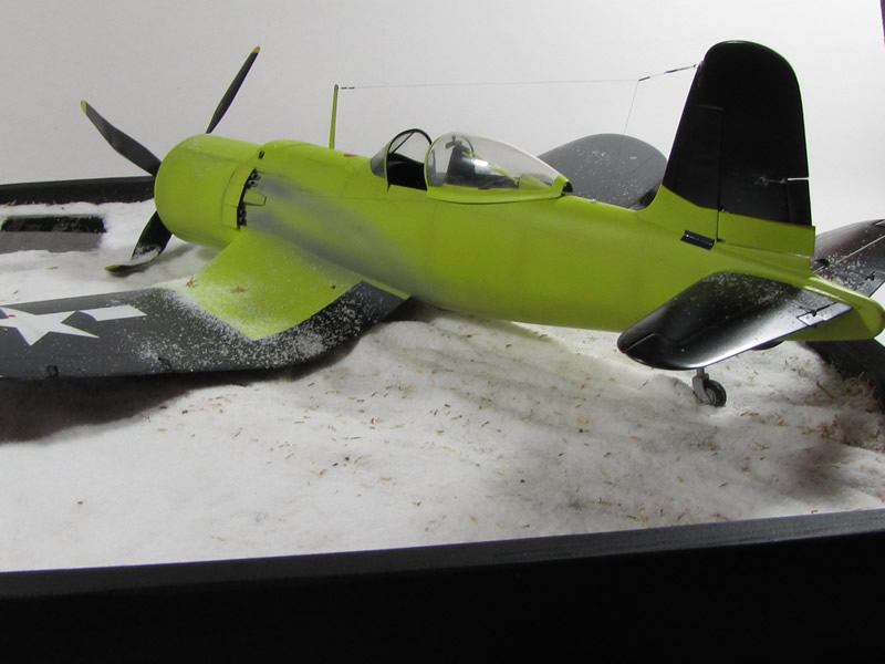

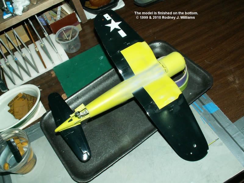

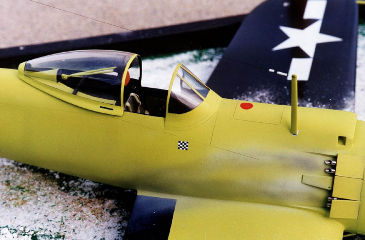

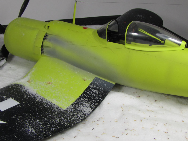

In mid 2010 I decided to enter the model at the IPMS/USA 2010 Phoenix, Arizona National Convention so I check out the model and discovered a big mistake.

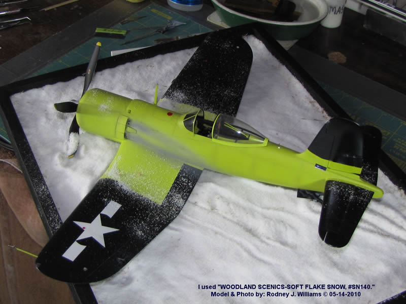

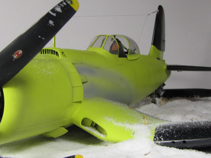

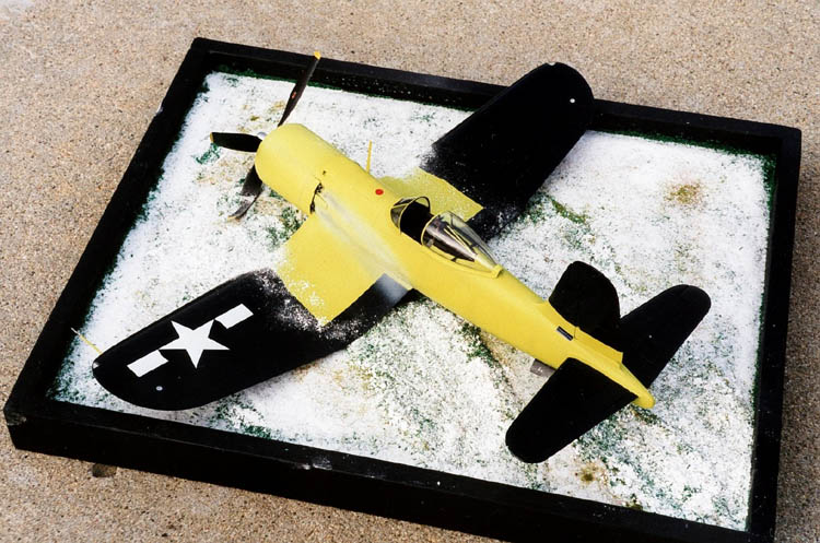

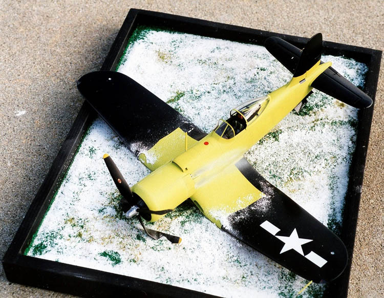

I used green modeling grass on my base and covered it with some baking soda to represent the snow that was in the photo. Hey, I lived in Ohio and there is no green grass to be found in the month of December!
It’s winter time - the grass had to go. I lifted the model off the base and brushed off the baking soda but not all of it came off. To solve that problem, I took my model to the kitchen sink and used some warm water and gently brushed off the rest of the baking soda…WOW! OFF CAME THE PAINT.
I carefully sanded the paint-less areas and repainted the model. This time I used modeling snow and dead “modeling” grass on my base. I assumed that over time the baking soda soaked up some moisture and stuck to the paint.
(I learned a good modeling lesson – don’t use white backing soda for snow).
The model took a third place award at the IPMS/USA 2010 contest. I have written a value price of ten grand on my digital image of this model and the price is two fold. One is for my insurance company and the other one is the sale price. I spent over 2,000 hours building the model. Over the past 25 years I have built several ten grand models for clients (1986 to 2011), so why can’t I sell this model for the same price?
