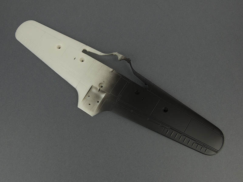

In order to put these new paints through their paces, I used the lower wing part from the 21st Century Toys MC.202 Folgore kit as a guinea pig:
I polished the port half with a set of Micromesh pads, and then followed it up with a couple of coats of Mr. Finishing Surfacer 1500 Black, to take care of any surface scratches:
In hindsight, I wish I'd used a grey primer, as the black base made it difficult to properly see how the SMS Jet Black was laying down.

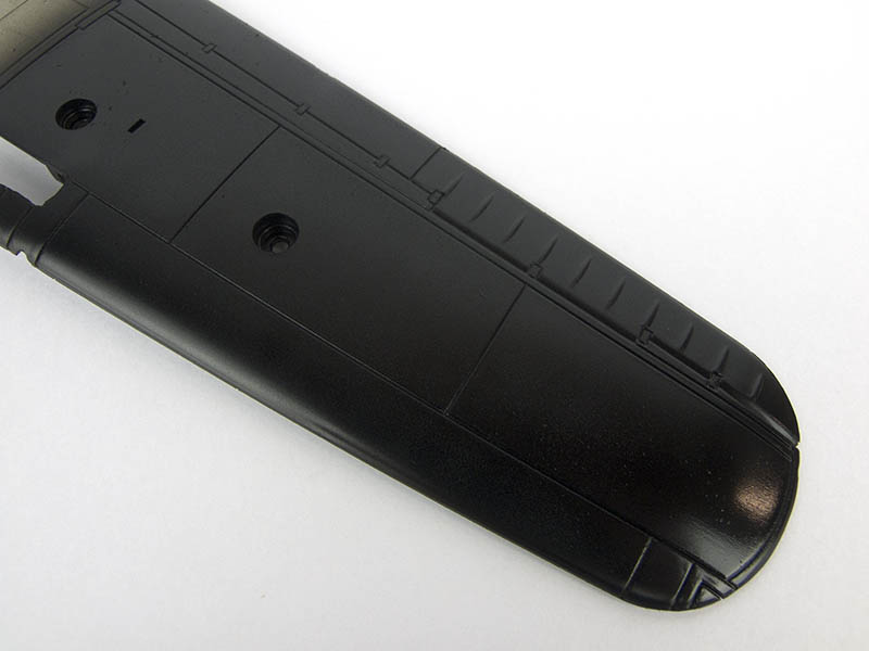

In pouring the Jet Black into the airbrush cup to lay down the gloss black undercoat, I felt that the paint seemed a little too thick to spray unthinned, but proceeded to try it as advised. It soon became evident that my hunch was correct, as the result shows evidence of orange peel and a general sense of 'lumpiness':
To test my assumption, I thinned the paint by 50% using Mr. Color Thinner, and sprayed the starboard wing section with the diluted mix, and had a much better result. But still, the airbrush felt a bit sputtery.
Since the aim of this review was to test the metallics, and not the Jet Black base, I decided to polish out the orange peel, ready for continuing the test:

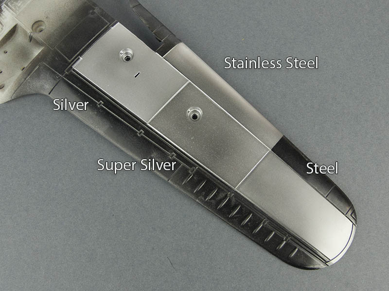

I masked off a panel, and started with PMT01 Silver. And again, I noticed that the paint seemed a little thick in the airbrush cup. At this point, I would normally have added thinner as a matter of course, but I needed to test the advertised performance straight out of the bottle. The airbrush sputtered again, but managed to deliver quite a pleasing coat of silver paint. I was suspicious, however, and decided to strip and clean my airbrush at this point.
And that's when I discovered I'd made a rookie mistake! Having not touched the airbrush for several weeks prior to this review, I hadn't realised that it wasn't in the pristine condition I assumed it was, and needed a clean. D'oh!
But here's where things get interesting: upon proceeding to the next colour, PMT04 Super Silver, I discovered that it was noticeably thinner both in the bottle and in the airbrush cup, than both the preceding paints. I checked the other paints, and it seems that both Jet Black and Silver were substantially thicker in the bottle than the other supplied colours, and require thinning to spray to their potential (irrespective of my dirty airbrush).
Unsurprisingly, the other colours sprayed like a dream, and completely nullified my apprehensions. The effect to the naked eye is very pleasing, and the photos below don't do them justice at all. Metallic finishes are notoriously difficult to photograph, and the graininess evident is a result of my sub-optimal surface rehabilitation (post-orange peel), rather than any feature of the paints themselves.
The other feature that the camera fails to capture clearly is the actual tones of the paints themselves, as the photos render them as looking a little more similar to each other than they really are. The Silver is a standard silver, similar to any other you might have seen. Super Silver is a slighter darker, richer version of the same colour, while Steel is a rich, metallic dark grey. Stainless Steel exhibits a pleasingly authentic quality.
