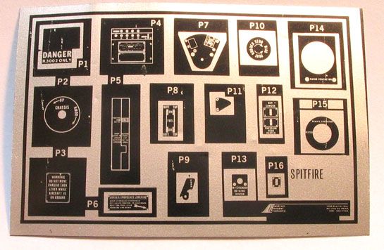

This review covers another Waldron Model Accessories item, this time the "Spitfire Cockpit Placards" set. In the same vein of the P-47 set and others from this famous accessory manufacturer. As usual, most data plates of the cockpit are black printed in high detail on a light aluminum sheet. Also included are photoetched throttle parts and a small resin radio box. Assembly is covered in a detailed instruction sheet. Be aware that this set does not includes the control panel instruments.
I found the placards included in this set more adequate to Mk V Spitfires, but the deviations to early versions are almost impossible to see. Therefore, this set will find use in every Spitfire variant up to Mk.IX (sorry folks, that´s where my Spitfire knowledge ends).
The placards are very well printed, since you can read everything there using a magnifying glass. However, as is usual with this type of Waldron accessory, you have to cut all items from the aluminum sheet and glue in the correct positions. This method can be dangerous (there´s no spares) and I recommend to protect the printed areas with the aid of a low tack tape before cutting. Also, the removed areas will invariably bend after cutting, but its flatness can be easily recovered by rolling a cylinder over the pieces.

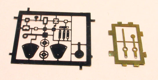

Once finished, the throttle will result a wonderful detailing piece. Its assembly, however, is not easy, as you have to sandwich many tiny photoetched details. All black parts of the throttle are pre-painted, so it is just a matter of careful cutting from the supporting tree and retouching where necessary.
The three circular items from the aluminum sheet (trim controls, chassis control unit and the contactor control box) will ask the Waldron punch and die set or an equivalent.
